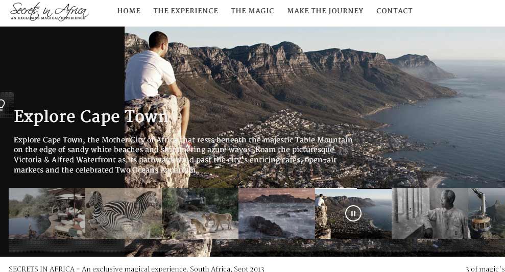

Any idea as to why the background color for an album image description does not work in IE 8 ?
IE 8
Works fine in Firefox and IE 9 ...
Post edited by spcshiptheme on
    edited October 2012 Posts: 10,970
    Cause IE 8 don't support rgba colors. I think I didn't add fallback color in this case. I will have to think about it. Any way it will be solid color, with no transparency for IE 8 and lower.
