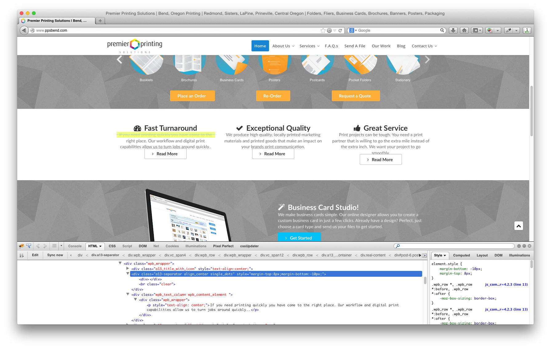

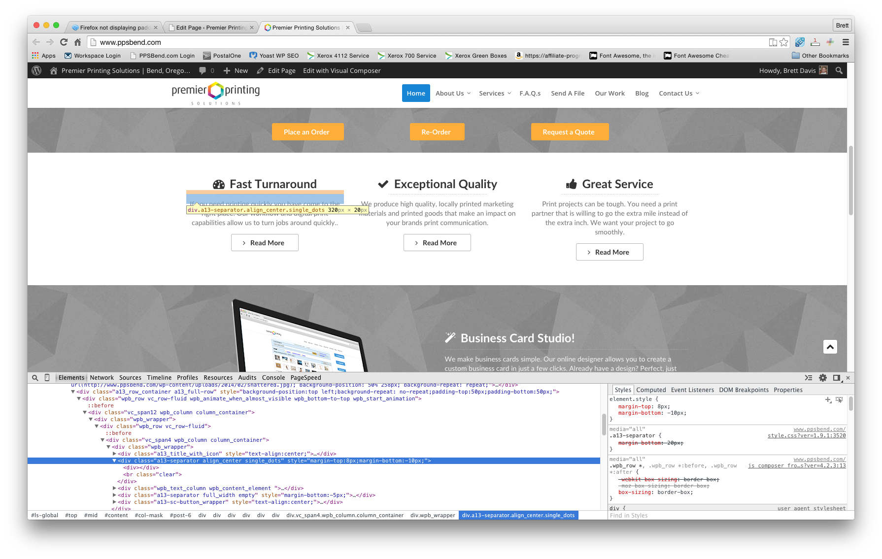

  • I am not exactly sure what you're referring to. As far as I can tell the margin values between Chrome and Firefox are the same. I have 2 additional plugins running that were not packaged with the theme.imageimage
    1790 x 1135 - 560K
    1790 x 1135 - 560K
    1792 x 1135 - 640K
